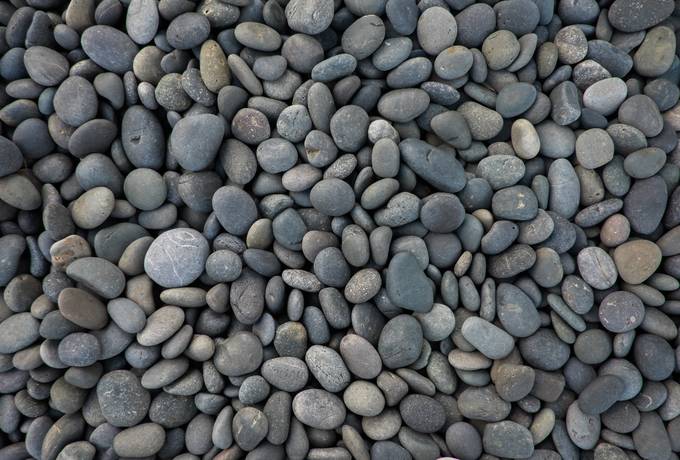

I would like to cover the floor of an interior with rocks like so.
How would I go about this?
Thanks
Thanks
Hi Tom,
I would use a nice pebbles stone texture which also has a nice displacement map. For example something like:
Pebble Pavement PBR Texture (cgaxis.com) or Pebbles PBR Texture (cgaxis.com)
Of course it won’t look as good as actual geometry but it’s also nice if you keep the scene from getting way too heavy. And since there is quite some depth I would use the diffuse/albedo in combination with an ambient occlusion texture from KS so you get some extra feeling of depth inside the renders.
